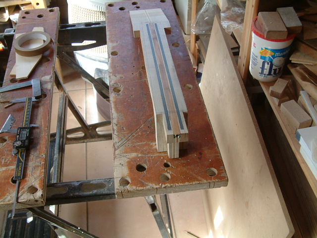

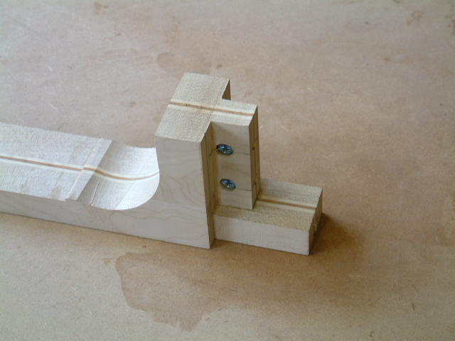

I have been thinking about my neck design and I hate the fact that
sometime despite a lot of work, there is a change in angle at the 14th
fret. (Neck body joint....even with a Woolson jig)
Some of this occurs despite what seems like the perfect neck angle.
Fretboards can bend a bit etc.   String tension???
To this point I have been using a duel tenon joint. (cumpiano tenon with
a fretboard tenon to hold the fretboard extension down.....Like John
Mayes, Kinnaird etc)
I dont like adding the 2nd tenon on the bottom of the fretboard.
Conceptually if the neck mahogany extended all the way down you could
GUARANTEE a perfectly straight neck.
Does anyone do this? It is similar to Taylor, but I am adding carbon fiber
all the way down. Also, I dont have shims etc to change neck angle.
It seems that adding the heel will be more of a challenge since I just
cannot route the angle anymore.
The picts below show my attempt. Also pictured is my standard neck
block with the baltic birch extension for the fretboard. The tenon will be
thinned a bit and the mortice cut out of the birch
Any advice????

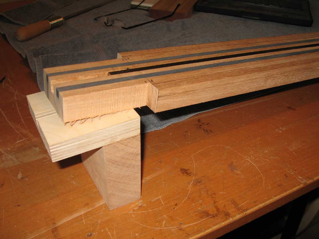

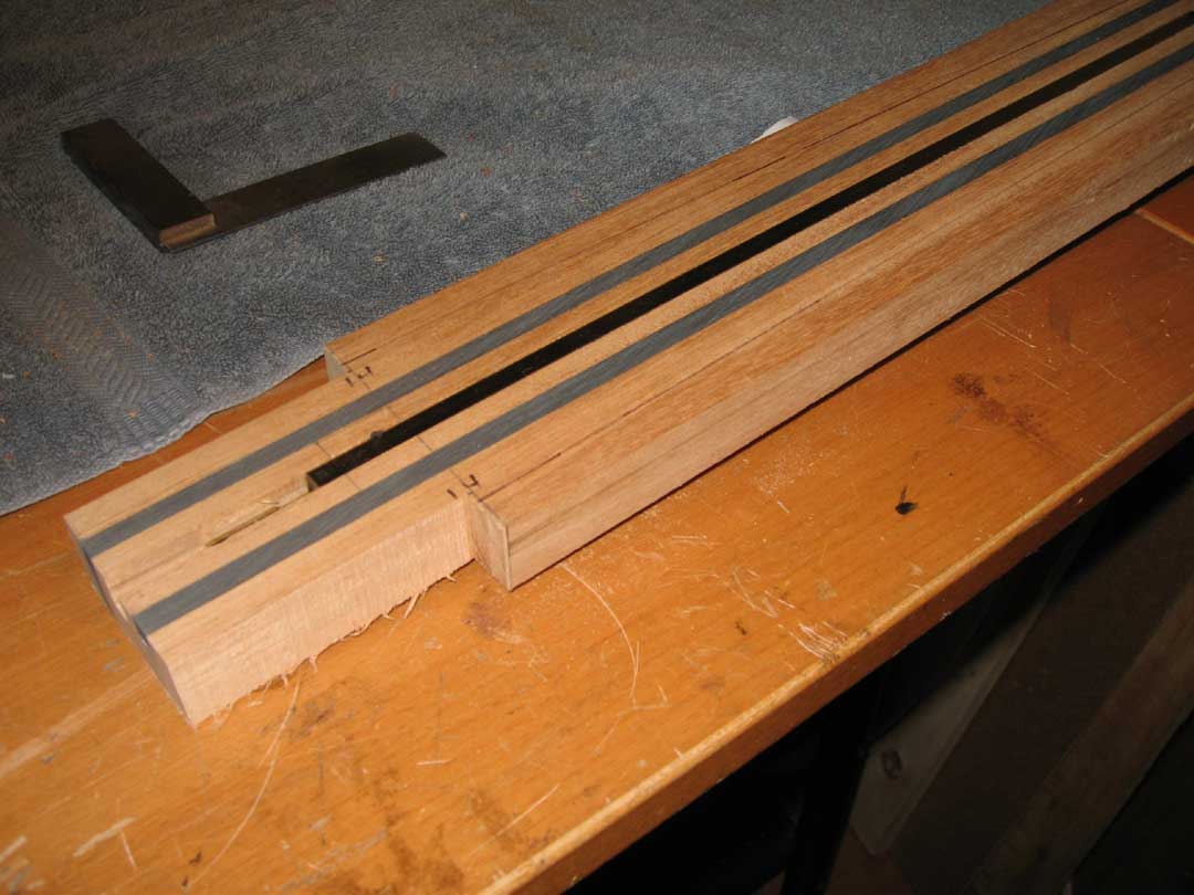

Andy, I do it very similar to the way you do. My method is sort of a hybrid of the Mayes system where I actually cut a mortise in the neck blank and insert the fb extension piece. Once glued in and having the fb on it, it's solid as a rock.
One issue I forsee with your design as it is, is how are you going to cut the tennon with the extension piece in the way? Looks difficult.

PostPosted: Mon Jun 26, 2006 10:09 am
Paul
That is why I posted the thread. I knew cutting the tenon would be the
problem. I was thinking of cutting on the heel piece before glueing and then
just fine tuning from there
PostPosted: Mon Jun 26, 2006 6:03 pm
Andy,
Do you mean like this?
PostPosted: Tue Jun 27, 2006 12:05 am
Andy and Dave, this is really cool and it makes that task seem easier, i really gotta try this on my next build. Thanks!
PostPosted: Tue Jun 27, 2006 3:33 am
Haven't done it yet, but a similar joint has been on the drawing board for at least a year and a half now..slightly thinner fingerboard extension though (more around the 1/2" mark)

PostPosted: Tue Jun 27, 2006 8:04 pm
I do the same neck extension on mine. I've stopped using a tenon now, but when I did I just cut the tenon onto the block before gluing it onto the neck shaft. If needed, meaning if I botched the gluing, a little correction with a chisel to get everything lined up.
